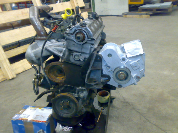

had some welding done yesterday:
Test fit on a external engine (nevermind the dutch). With the pump on maximum pre-injection, there's room, but only just. Nothing serious, since the fitting plate has some room for adjustments build in. The (gas?)lever is freely manouvreble.

It's been a month now since my last posting, so time for an update..
I allready bought myself a G40 charger (Polo 2f, later model).. and have been sourcing specific Polo 2 G40 stuff since then. A Polo 2 G-charger would offcourse be the cherry on top, but I since there's a serious chance the charger will blow, and I'm not willing to destroy a 'typ 1 charger' for that purpose.
Anyways:
G-charger exit arch: Not the differences between radius and thus ' height'
Not only is the 'off-set' different from the polo 2f charger-exhaust, it's got a different angle to:
On the good-old Polo 2, the intercooler is fitted allmost directly underneath the charger, since there's no real space in the car front section. With the longer, much rounder front on the 2f, Volkswagen decided they could make things much easier for there mechanics to change stuff on the ' most powerful polo', and reduce production costs abit more. The Polo 2 G40 was quite labour intensive to build. I've read somewhere in the past that even Karmann was involded in cutting up the front section and installing the G-charger...
Anyways:I bought my charger from some guy who's doing a lysholl swap on his Polo, and the visual state of the charger was quite good. I had ' Arno ' do a checkup, and he did advice to do a complete rebuild. Picked it up last month:
It's the 51'st charger he has rebuild, and included a full 'glass-perl-blast-job', all new wearing parts (seals, bearings) a fresh lube with kluber grease, etc etc..
He did a fine job, and I really like the way he's working: clean, exact and patient.

First test-fitting on the engine: no problems at all:
But,.. As you might notice, (and what I've stated before) there's about no room for the tubing to get from intercooler to inlet..
