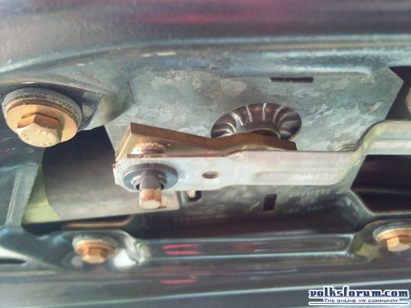

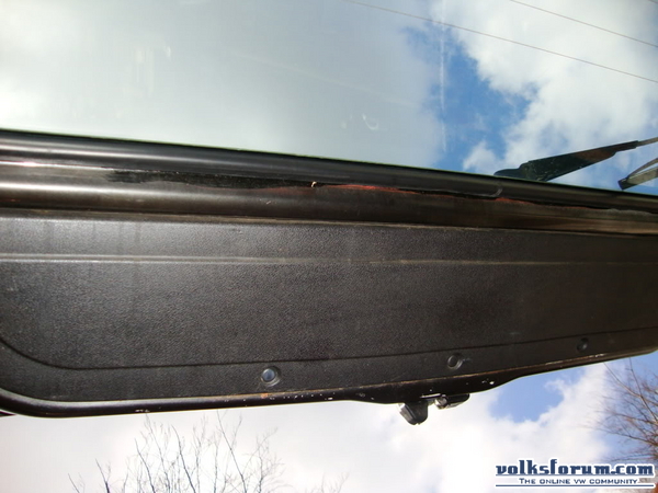

First you will have to open the hatch, and prise off the cover on the inside, to get access to the wiper linkage.

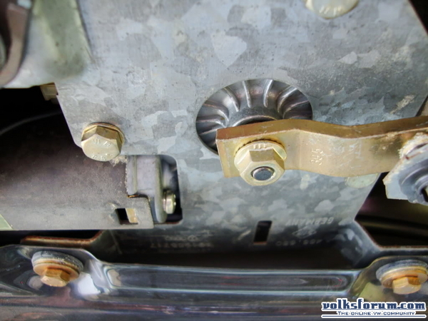

Then you locate the wiper-motor, and you will se that there is a crank-arm fitted to the rotating spindle on the motor.

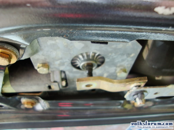

All you do is to remove the 10mm nut on this crank-arm, and you rotate it 180 degrees, so that the wiper-arm is low on the window.
Then you refit and tighten the 10mm nut, and refit the cover.

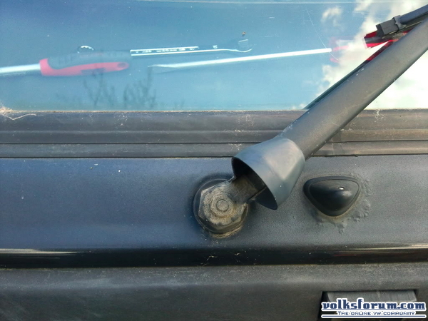

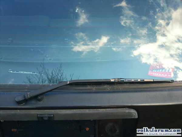

Now shut the hatch, remove the 10mm nut holding the wiper-arm to the spindle, and adjust the arm so that it is to rest at the lower edge of the window.
Fit the 10mm nut, and go inside the car and test the rear wiper, to see if it works properly. If not, make some adjustments and try again.
It's that easy, and done in about 5-10 minutes, so go ahead!

eerst kofferdekselverkleding losklikken
let op je de clipjes niet kwijt geraakt
dan zie je de mechanisme
daar moer 10 losmaken en lostrekken van motor
daarna as 180 graden draaien
moer terug vastzetten
en dan ruitenwisser eens testen dat die op homepositie komt
ruitenwisser losmaken en gelijk zetten met rubber en wij zijn er
vergeet niet binnen de klep terug in te klikken
groetjes en is in een paar minuten gedaan
